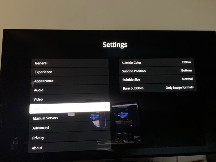

I have come across an issue with setting this up.
Some clients like my Samsung Smart TV, can‘t use Direct Play on .mkv files with ASS subtitels, so they use HW.
Before the „Upgrade“ to the DS1520+ and DSM 7, this is how it should look:
But now on my TV, because Plex doesn’t burn them in automatic and shows subtitles only on the bottom, all German subtitles you see on the picture are show one above each other at the bottom.
And all clients who use Plex on PS4‘s, there looks to be no option to set up „only Image Format“, so on their PS4 it keeps buffering.
Is there any other workaround for this, then changing the subtitle burning option?
Why do subtitles suddenly disable a portion of HW assist? Is it again because of DSM 7? On my previous DS418play with DSM 6 these videos streamed with subtitles burning on automatic and the new DS1520+ has a much powerful CPU.

This is how it looks on my Samsung TV now with the subtitles not beeing burned in.
I forget how the Samsung app is structured but don’t you have control over where the subtitles are placed?
I have control of placement in my Shield app
In my LG web app (should be almost the same as the Samsung app)
The TV doesn’t have full support for the ASS format.
AFAIR, if you select “only image formats”, you lose almost all formatting of ASS subtitles. The server will basically extract the pure text and send this unformatted to the TV.
If you want and need the full formatting, you will have to let the server burn-in the subs. i.e. set “Burn Subtitles” to “Always”
Yes I can. And it seems, that exactly there is the problem. Animes with fansubs often have ASS subtitles and these can have the subtitle-text all over the frame like in my example. Depending on where the japanese text is, that is been overwritten with the subtitle text.
The Plex App on my Samsung TV overrides this positioning with the one set up under „Subtitle Position“, so all text is shown in my place at the bottom.
Surprinsingly I connected an Apple TV to my Samsung TV and with Subtitles burning on „always“ and forcing it to do HW by dissabling direct play in the settings, it doesn‘t buffer at all. I think it has to do with a settings option the Samsung TV doesn‘t have, translated in english it would be called like „Embedded subtitle formatting“. With this one ON, it seem to override the Subtitle Position Setting.
So the high CPU ussage on the Samsung Plex App while HW didn‘t actually come from the burning in of the subtitle, more from the having to move the subtitle from its position in the ASS-file to the one specified in the settings.
That could be solved by adding this feature to the Samsung Plex App. Is there a reason thos feature isn‘t in the Samsung Plex App?
