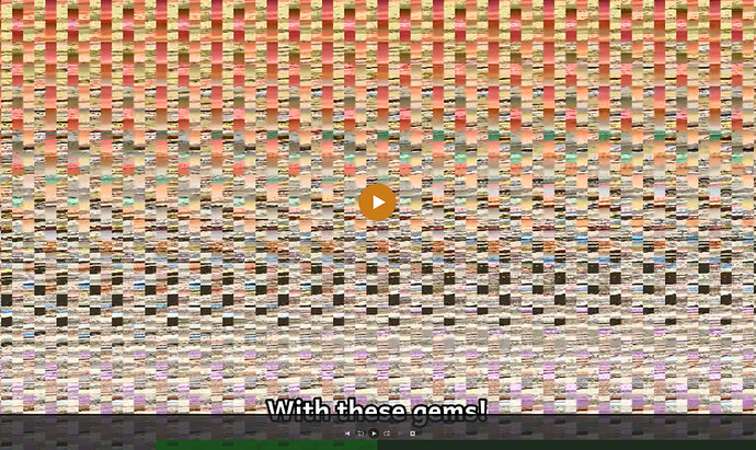

Plex 1.18.2.2058 running on a Synology DS218+, have Plex Pass (so HW transcoding is enabled), having this exact issue. Went ahead and renamed the Intel driver and it does prevent the image from being completely trashed (blocks of color). But transcoding still ends up causing buffering every 20-30 seconds.

I am or was in the same boat as everyone else. Transcoding stopped on my Intel J4105 board running Ubuntu. So after going through this entire tread and stumbling my way through command line I managed to get mine working again by removing/renaming /usr/lib/plexmediaserver/lib/dri/iHD_drv_video.so driver. I first tried i965_drv_video.so as others had suggested but things still weren’t working.

This new version (2148) breaks ALL media files. Now every movie, regardless of with or without subtitles, it’s scrambled.
