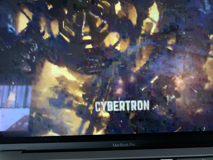

Using your package on my DS918+ results when transcoding with h264 codec in a complete pixel, blurry picture. but works. Not so with h265. please fix
best regards
Ekomax
I am not sure I understand what is going on in your feedback. Can you please give some more info? Logs? screenshot?
@chrisallen
If i transcode h264 media the picture is very burry. like transcoding to the lowest possible bitrate.
when transcoding media (a movie) with h265 codec (hevc) this does not happen.
Does the issue go away after 30 seconds of transcoding? I think you might be hitting Pixelated playback when Transcoding for the first 60-90sec

You are right, around 30-90 sec - picture gets normal. Whats that now?
