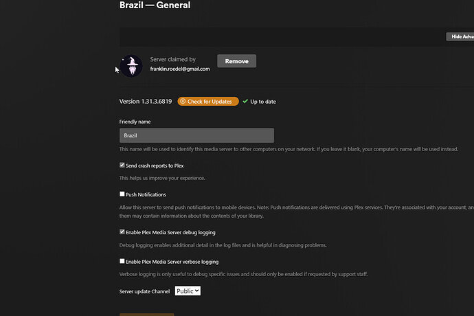

Upgrade was successful. Please find logs and screenshot inside of the container. I am using portainer for that.
