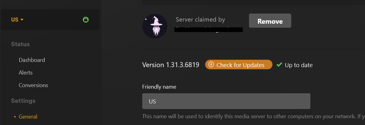

That’s the thing. I already have a PMS installed on host, running 1.31.3.6819. It works completely fine.
Let me explain my setup a little bit.
I have Hardware Server that contains two PMS:
   -  "US" - contains local libraries such as movies and TV shows.  It also contain US a xteve with  US Channels . This PMS server is installed on the host or as we usually say "bare metal"
  - "Brazil" -contains Brazilian channels , also running with xteve.  This is the problematic PMS server. It is running on Docker.
This is the server where I have been testing. Everything works with version 1.29.2.6364 but when I upgrade the version to the latest it fails with errors I already mentioned in the previous messages.
