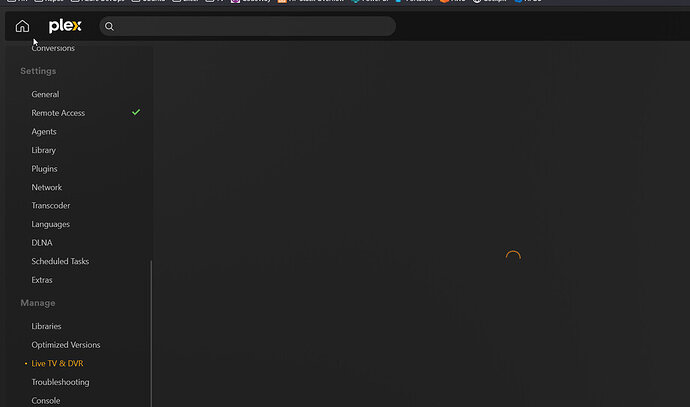

  1. Ran b std::invalid_argument::invalid_argument
  1. tried to open a channel but I was not even able to load them
