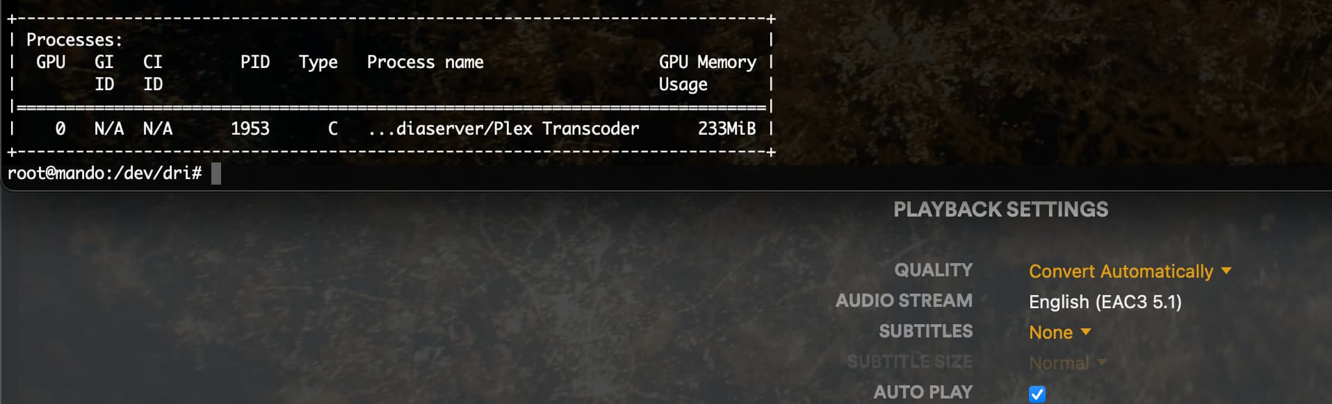

I then enable hardware transcoding in the settings, to use the P400 and it will still directly play, but when I change the quality to 720, the stream stops dead and nothing is passed to my gpu, I can see from Nvidia-smi that nothing is being passed to the gpu.

Interestingly, I did see the gpu transcoding without the above changes, when I clicked on “Convert Automatically”
So I know it does work with the GPU and the dual Xeon processors when I convert automatically but nothing on any other quality.
