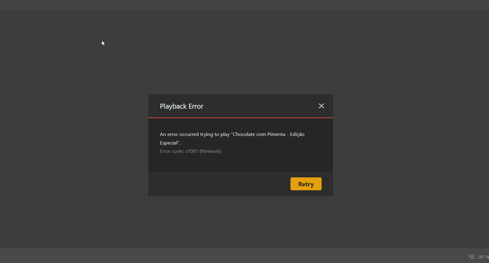

I’ve also updated to the latest and still have the same issue as before. I have made some progress as I have found that if I select “convert automatically” it passes the stream over to my Nvidia GPU. I can see the stream if I run Nvidia-smi.
However if I select any of the qualities such as “convert to 720p HD” the video hangs and never gets passed to my GPU. I have downloaded the logs and happy to attach them or DM them across.

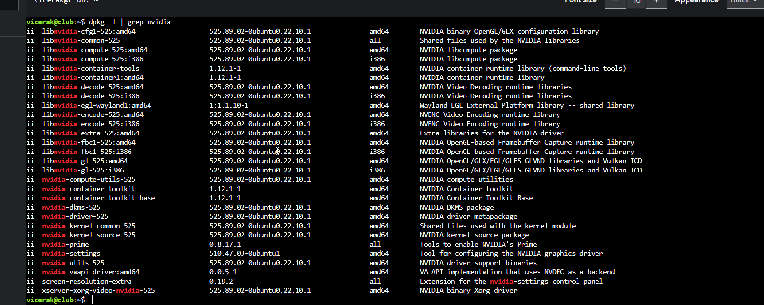

dpkg -l | grep nvidia
Is there anything from the old drivers ? (check the decode and encode packages)
See bellow:
On the side of caution, since we don’t need them anyway
remove the i386 libnvidia packages.
When you look at mine, there aren’t any 32 bit packages

Done. Same results.

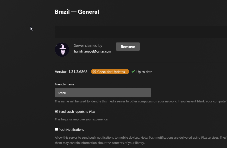

I eventually upgraded to 1.31.3.6819-2ef591a4c_amd64.deb (beta!) and the transcoding was working. I have updated since then an all was fine. Not sure what version I’m on, just now, I think I am one version behind :thinking::man_shrugging:
Just checked :joy_cat: I’m on 1.32.0.6918, and all is fine. I even updated ESXi to 8.0c and all is well :grin:
