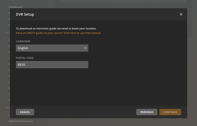

Please forgive me if this is in the wrong category. I am new to Plex and was setting the DVR function up in the UK with a Hauppage Duel HD tuner. All works really well (Goes off and finds channels from my local transmission station) until Plex needs my post code to find the most appropriate EPG. No matter what local post code I type in the box, Plex never allows me to continue from this point. I have set up this before and it worked perfectly but now no dice. Am I missing something or is this service down at the moment?

I also have the same issue, stuck on postcode in the setup, I am running Version 1.19.4.2935.
It worked ok before but now just stuck grrrrrrr.

Have you been typing in the complete post code?
for the UK, only type in the 1st part of the post code eg: OX1 (but not OX1 4DG)

Yes I only enter the first part of the postcode e.g. XX1 not the full postcode XX1 2XX.
This worked before, but today as the UK needs to rescan to find the moved TV channels, I deleted the DVR and started a fresh, it finds the card and all the channels just sticks at the EPG postcode :frowning:

When trying to add the device from scratch, I’m stuck at the postal code screen (sometimes I can see the next screen but then it’s remains stuck at 0%).

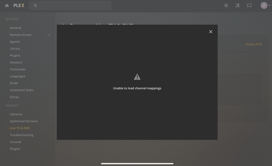

Is this normal in this context that I can’t tune channel (error 5000) and that I can’t load channel mapping ?
The problem should only be impacting: DVR Setup and EPG refreshes
If it is affecting existing channels and live tv then would like to see logs and what was being tuned

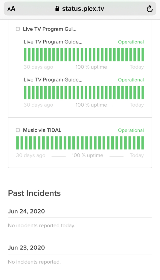

Plex aren’t currently reporting any probs though…
