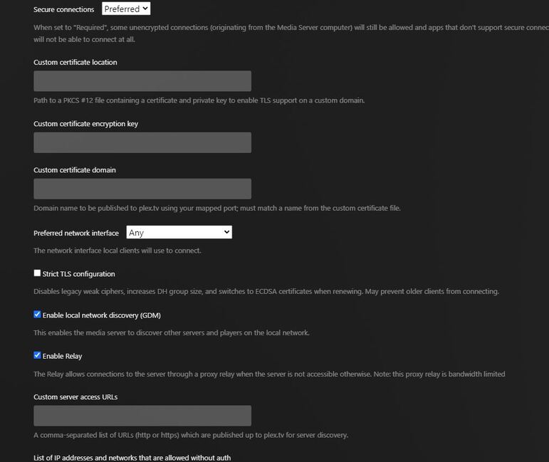

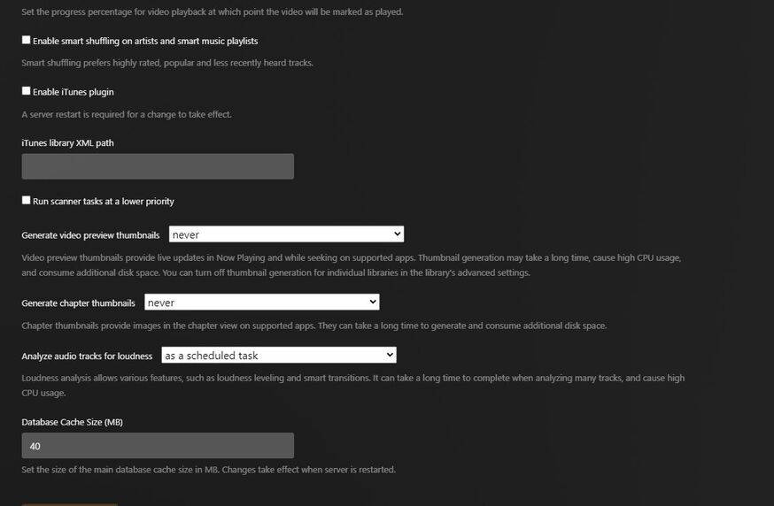

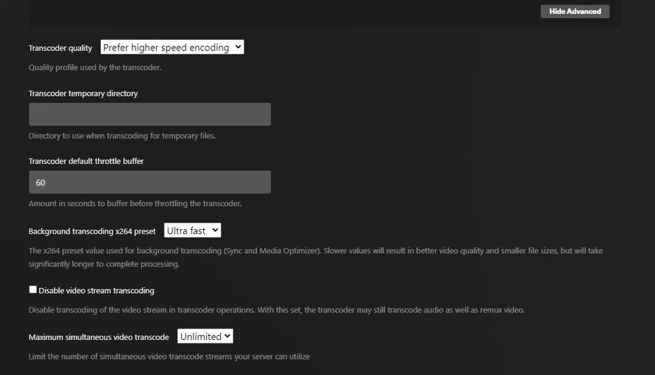

Here are all my following Settings:
Some of the refresh Local Media and Update Libraries I have turned to off, because it changes my meta data. So I generally keep my System on low maintenance and just do most of the clean up my self manually.
