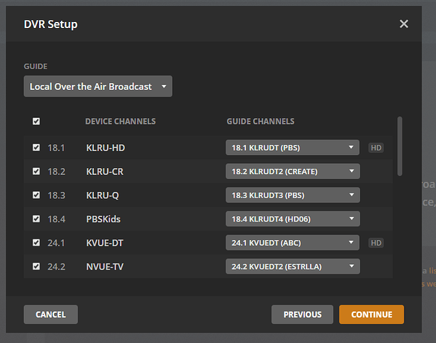

The problem is that the “live tv” is missing from the side bar on the home screen. The setup goes through and downloads the local tv listings based on my zip code and then the option to “view guide” is not selectable. I close the setup and go to the home screen to find that my live tv is still missing. I have attached a log from tonight and pictures. I hope that this helps.
