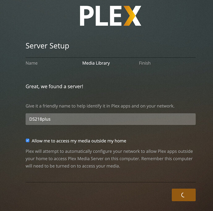

I just did this again, same result. Here’s a screenshot of what I get when I restart Plex and log back in. It sees the server. It gets hung on this screen for about 5 minutes, finally giving me a “problem claiming the server” error.
Attached are the logs. Logs(2).zip (1.3 MB)

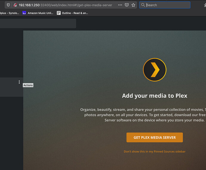

When I launch Plex from my DS218+, Plex no longer even sees the server or my media. Instead I get this:
I have stopped and restarted. I even uninstalled and reinstalled Plex on the server, and I get the same error message. Why would Plex not see the server, if I’m launching Plex from the server? What am I missing here?
Logs(3).zip (1.4 MB)
