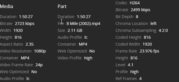

This is an example video that was unable to played in 1080p:
winter
Quality isn’t the setting for them.
Remote Quality is.
If they set Remote Quality to, say, 12Mbps 1080p - whatever that is in the app.
The file as you have shown should Direct Play.
We didn’t see the audio.
We didn’t see the subs, if any.
and we didn’t see your Dashboard in progress.
For your part:
You can’t do anything at the server for them.
Other than feed them material they can Direct Play.
It’s all them and their Remote Quality Setting.
