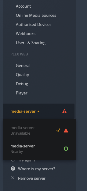

I originally said that it was like Plex had never been installed before, but I realise now that that’s not true. Here is what I see in the app:
So, it does seem to be aware that libraries existed, but I get this “media-server is currently unavailable” message.
Thanks for you help.
It appears that I now have two “media-servers”:
Is it possible that the one that can’t be accessed is my original library?
