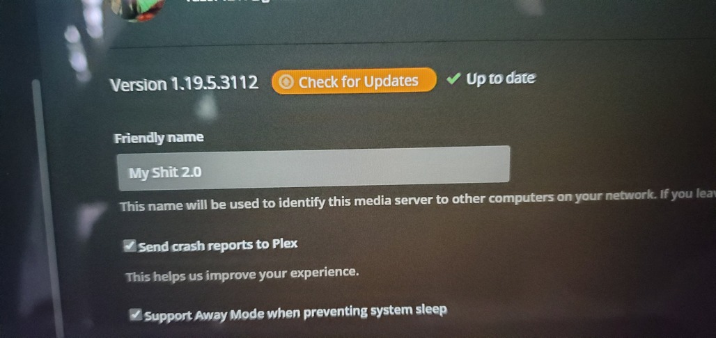

Server Version#:
I’m all up to date. Everything plays nice for 2 days and then shuts down. I can access my library from my phone or a computer, but am unable to access from my Samsung TV, or PlayStation apps.
I’ve checked everything on the generic help 101 page, no help.
What update channel are you using (public vs. beta)?
Up-to-date can mean different versions for those two.

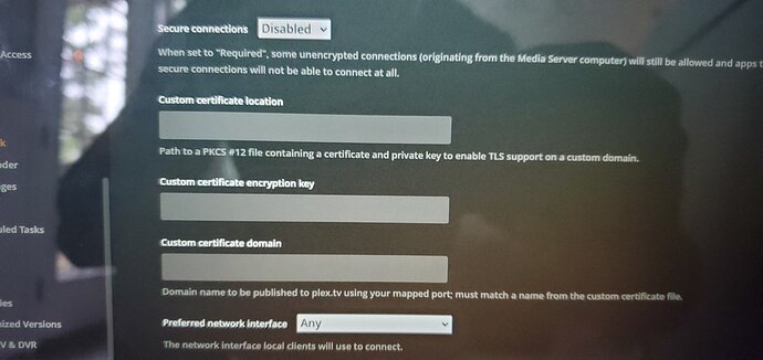

Have you checked if this could be related to a network issue (as you can still access the server from your other clients on the same network)?
Could be the devices are on a separate subnet or your PMS getting a different local IP address from your router’s DHCP server that causes those 2 clients to no longer find it.

Correct… there’s a Plex Pass feature in the Network settings of your Plex Media Server. There you can enter IP addresses of a sibling/child subnet for Plex to consider it part of your LAN.
