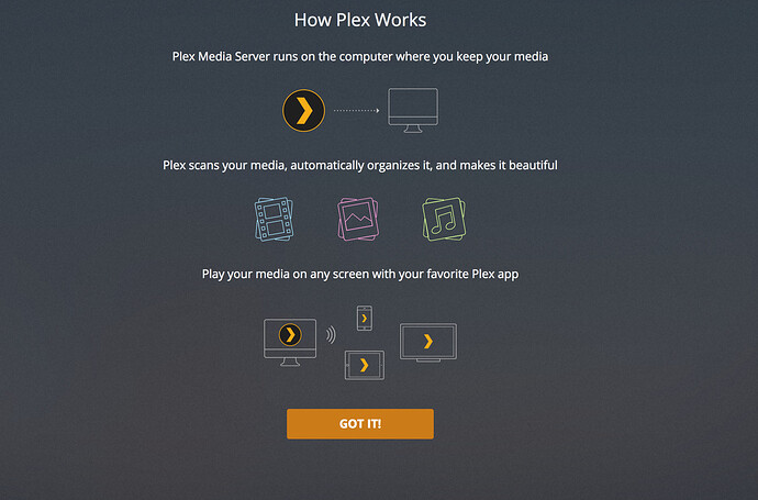

HELP! Plex keeps redirecting to the initial setup page - can't access web UI
The server runs but I can’t access Plex web - it always redirects to the ‘How Plex works’ screen and then tries to wait for the server to start before saying there is an error with my system.
c7eaf8026c9868b5a4a2bac92e4ef0b4c500bf88_2_690x455
I’m on Windows 10 and this is not the first time this has happened - it also happened a year or so ago. On that occasion I had to reinstall the server from scratch. I figured it was a random glitch but now it has happened again. I have just done a full re-install of Plex including clearing out all preferences and Plex keys from the registry. I managed to add a few libraries and then it happened again - I can’t access the web UI at all. What the hell. Does anyone know the cause? I found some old posts mentioning it but nothing recently.

The frustrating part is that I frequently get a glimpse of the web UI and my media before the 'How Plex Works" screen appears - it’s there I just can’t get at it. I can also access my media in the Plex app on iOS and Apple TV. I just can’t manage it or make any changes to my libraries because I can’t get into the webUI.
If I try proceeding and going through the setup. It just spins the loading for ages before reporting an error with my server.

I have finally managed to solve this. I purged Plex from my system again - uninstalled, cleared registry, deleted preferences. I then cleared my Brave browser cache. Finally, I then went through my online Plex account and removed everything from Authorised Devices. I then re-installed and so far it is behaving normally again.
I suspect there was some conflict between the current and a historic authorization of Plex web on my machine in Authorised Devices. I can’t be sure but given that the local machine was clean, I am pretty certain that clearing everything from there is what fixed the issue. I’m sharing this in case anyone else encounters the same problem - just delete everything from Authorised Devices. I suspect that I probably didn’t even need to delete my local Plex database.
