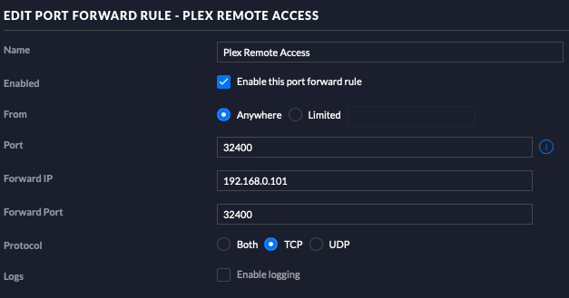

It actually doesn’t ask me which IP address to send it to, but I did make sure to set up a rule:
That’s your Windows IP configuration. Somewhere in your router’s port forward configuration for the rule you showed above you should need to enter that IP address. Do you have a screenshot of that?
For example, here’s mine:
Yours will obviously look different, but there are always 4 important pieces to a rule:

Okay, might be worth trying to set your local ip for your server as static on the router matching the port forward local ip and then change the windows config to automatic obtain.
But definitely check with your ISP, they may block port forwarding and they might need to allow it for you.
