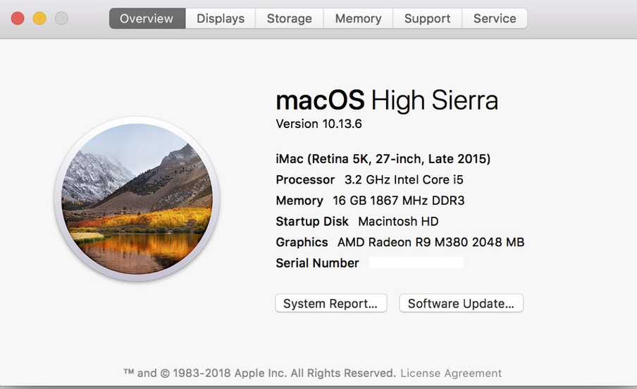

A couple questions first, what version of Mac OS are you using? System Preferences/ Security and Privacy/General, have you got allow app set to app store and identified developers?
The iMac I tried installing to is on 10.13.6 and the installation just seems to fail without any obvious error message.
Apps are allowed from App Store and identified developers as in your suggestion.
