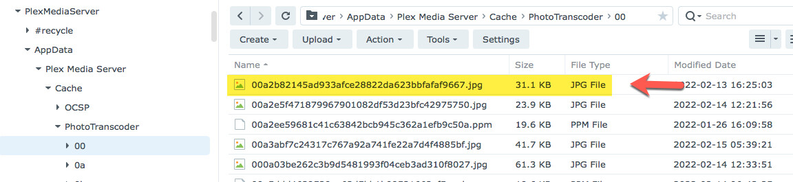

I was looking through my Synology System to see if I could find them and found this…
There are a LOT of these folders that seem to contain “pmm” and “jpg” files that are super small and then I look at these, they seem to be a thumbnail of full image. Would just be possible to remove all of these jpgs and then run a scan? When I looked at the highlighted image, I was able to find its full image…
Have a look at this thread for context Cache/PhotoTranscoder Folder Size Sanity Check
That cache can be safely deleted and plex will recreate it again as needed.
So this is NOT where Plex is storing the thumbnails?
I am beginning to get desperate on this.
I’m sorry, I guess your talking about photo library and not thumbnails from movies, shows or episodes.
Ignore all I said about and let’s wait for someone from plex to respond.
