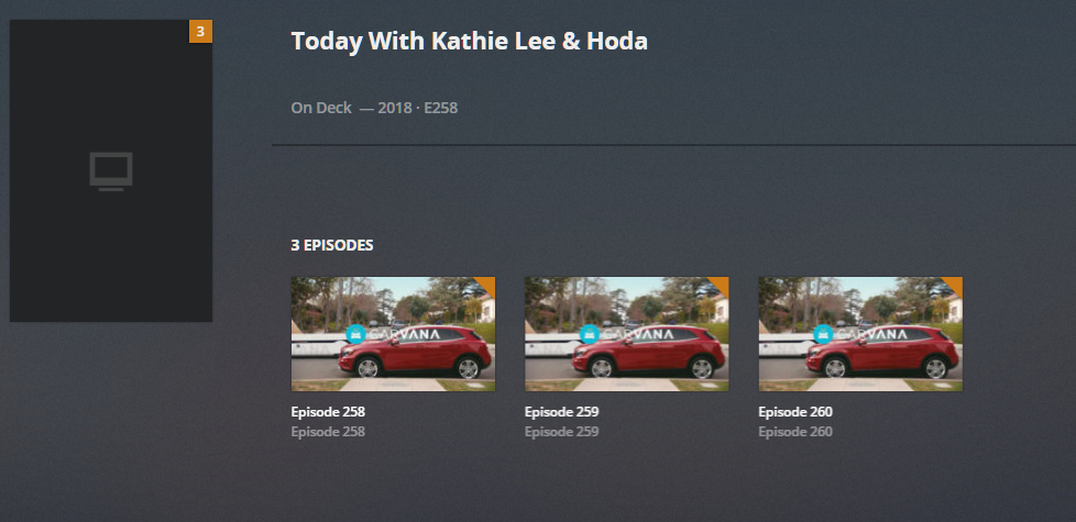

Any suggestions on how to change the generic thumbnail showing on PMS for recorded TV shows? See below, most of my shows with a series keeps showing this stupid Carvana image.

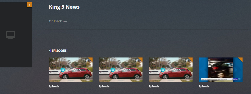

The Carvana thumbnail is showing up on many of the other shows, not just the one I screenshot, so its not grabbing from the shows

that carvana thumbnail is showing for shows in a series for multiple shows that were recorded using the Plex DVR connected to a HDHR Prime. Some of the thumbs in a series shows the carvana image and newer ones are showing a frame from the recorded show. It seems haphazard. All shows with carvana image were recorded using Plex DVR
And this picture doesn’t appear in the video?
Maybe it’s kind of like a sponsor message at the beginning of each show or something?
No because it is showing on different recorded shows from network and premium channel networks.
