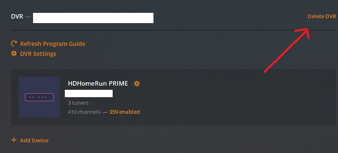

Cant you just Delete the DVR from your Plex?
Ok, forget about it. Thanks to nokdim’s answer I was checking more deeply the Plex options because couldn’t find it, and found instead an old plugin I had installed related with DVBLink and Plex. Uninstalled and fixed :slight_smile:
Ok false alarm, it is still happening and I don’t have the option showed by nokdim as you need a Plex Pass to use it… which I don’t have, so there is nothing to disable it.
