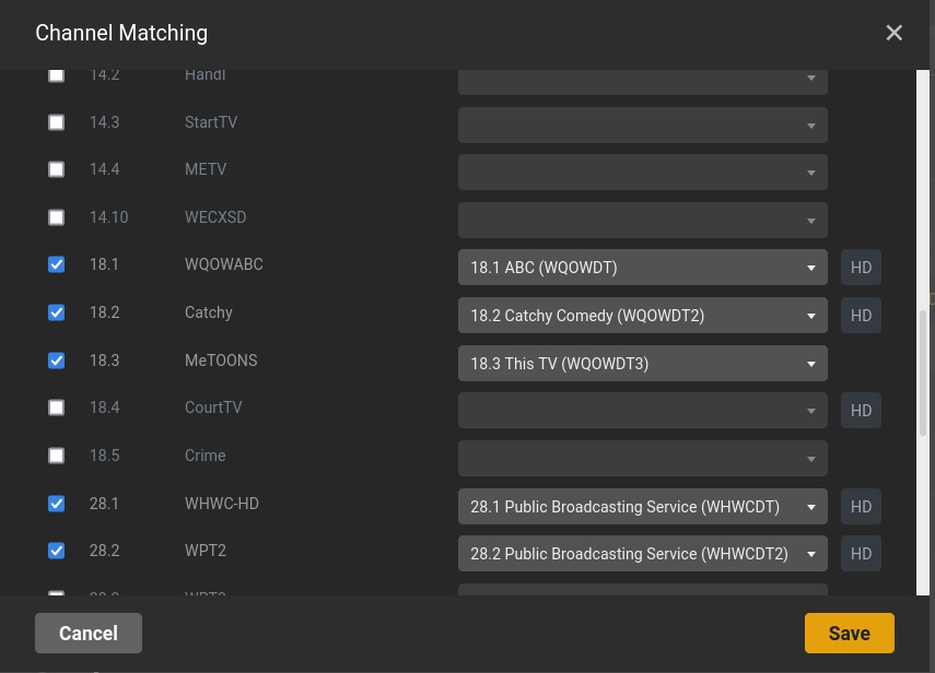

How to get guide fixed?
Server Version#: 1.40.4.8679
Guide/Lineup name: ThisTV
Channel number/Name: 18.3
Region: Eau Claire WI 54701 Antenna
This channel has changed a few weeks ago to MeTOONs. A rescan shows this from the tuner (see attached screengrab). But the guide still has this channel as This TV with just “SIGN OFF” as the current programming. I’m assuming This TV is no more. I would like the guide to reflect what is actually on 18.3. MeTOONs shows up nowhere else, so I can’t map it to MeTOONs somewhere else. Can someone at Plex fix this?

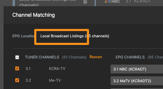

[Edited]
Your postal code: 54701
The call letters of the channel: WQOW
the number of the channel: 18.3
Lineup name: MeTOONS
sorry the line up name would be like “Local Broadcast listings”. it should say here . You said “antenna” so that is probably it, but want to make sure
Cursor_and_Plex
Cursor_and_Plex
Yes, Local Broadcast listings then. Mine actually says ‘HDHomeRun CONNECT DUO’ under ‘CHANNEL SOURCES’, but under ‘Channel Matching’ it does say ‘Local Broadcast Listings’. I’m running with the Linux Server version 1.40.4.8679. Sorry, I’m not very familiar with the jargon.
My guide is now correct. Thank you.
