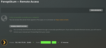

Open your Plex Media Server’s web interface and go to Settings > [Server Name] > Remote Access. Make sure remote access is enabled (obviously). Then go ahead checking Manually specify public port and enter the public port you had previously specified in your router.
If you don’t see this advanced option, you need to click on Show Advanced.
After clicking Apply / saving your changes, Plex should attempt to re-establish the server’s remote connection. You’ll see the “results” at the top of the remote access settings

knowing that additional info…I was able to create a port forwarding in my router using the 32400 on internal/external.
That sound right? I think it’s working. Some more testing to be done.
