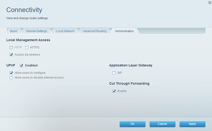

All the settings in my router are the defaults. I had just seen a reference to the router using NAT-PMP to establish the connection and didn’t know if that was the same thing.
Hmmm… Interesting in the admin section that now I see UPnP is enabled there.

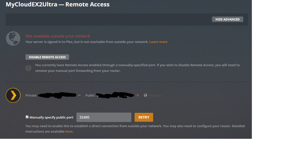

EDIT: So I checked the “manually set port 32400” and then it with the canyouseeme link. It said, " Error: I could not see your service on xx.xx.xxx.xxx on port ( 32400 Reason: Connection refused." (X’s added by me.)
I’m going to try to manually set it in my router. This is what the PortForward.com link said to do in the Linksys Router. Second screen is Plex…
Now that you have the port forwarding setup. Try shutting down the PMS server, reboot the router and wait a minute then start the PMS back up and then check to see if Remote Access is working. If not may have to toggle it off and back on (the Disable Remote Access button).
Ha! Saw the green “available” for a split second and then it went back to the red “network not available.”
Question… in my ipconfig command prompt, it lists my device IP as 192.168.1.1 which Linksys will not accept. I used the Device IP listed on the Plex Remote Access page which was 192.168.1.142. Is that correct?
In my screen snip above, it shows a red “X” next to my public IP. Does that have anything to do with this?
Use the address that is used for your PMS server.
Good, because that’s what I did. Still with no success though. What about that red “X” in my screen snip? Nothing?

So, in desperation, I rebooted my router and then rebooted my NAS… now I’m getting a double NAT error message. I did send my ISP a tech ticket.
My setup is: Wireless broadband from a tower to a dish on my roof. Ethernet into the house to my Linksys EA6900 wifi router. That’s all, no modems etc. NAS is directly connected to the router with an ethernet cable.
I think my brain hurts again and I think I need more beer.
So, just an FYI. I finally heard back from my ISP last night. This is definitely something they will need to enable for me. So, thank you for all your help, but none of it was going to work! I am definitely double natted according to them. This is a small company called Wisper Internet which just acquired my even smaller local ISP. The two are still somewhat separate according to the tech, so it might be tricky, but he is working on it.
