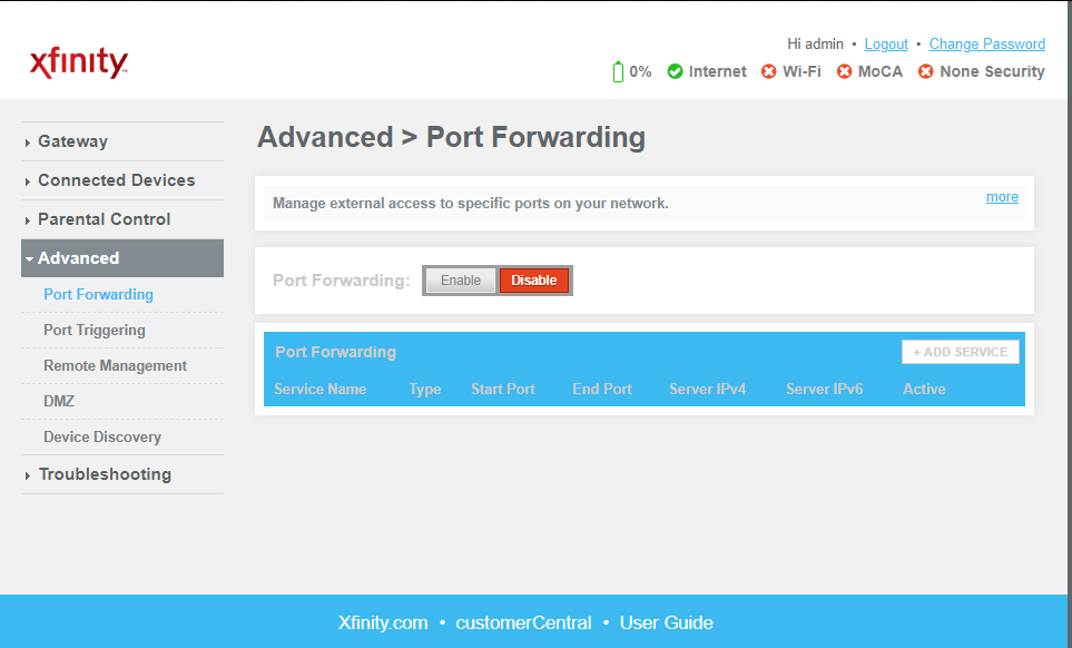

this is my Cable Modem setting. “No Port Forwarding”
my set up at home is
Xfinity 1+gbps (Cable)
that connects to a Xfinity Gateway (Wifi disabled - just using this as my “Modem” since i’m forced to rent their hardware at this moment until i can buy my own modem."

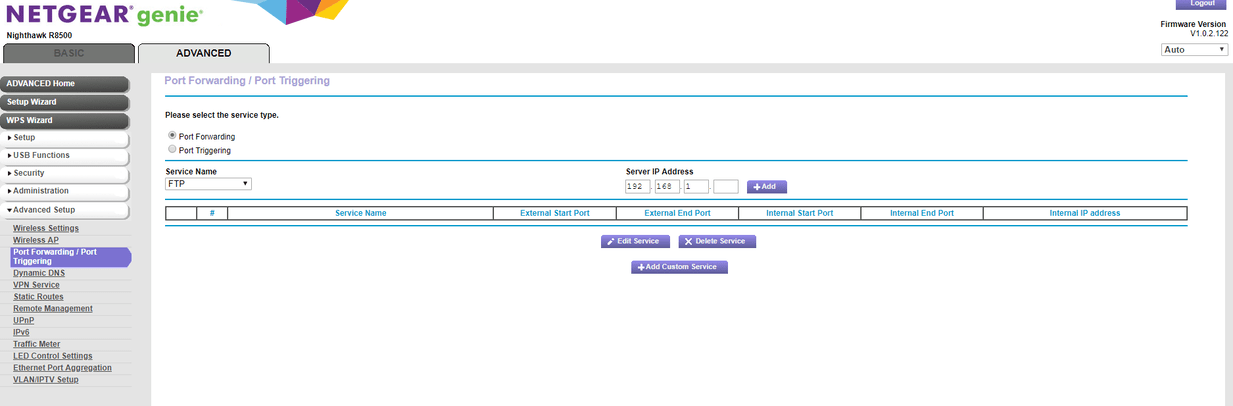

Netgear X8500 Wireless Router (this is what has EVERYTHING hooked up to it wither wireless or Direct Conenction
Below is the image of the Netgear Nighthawk Port Forwarding enabled
please let me know if there is anything else i can screenshot for further guidance from you.
i’ve never really messed with this before so this is a semi new area for me
You don’t have a port forwarding rule there. ( netgear seems to call a rule a “service”)

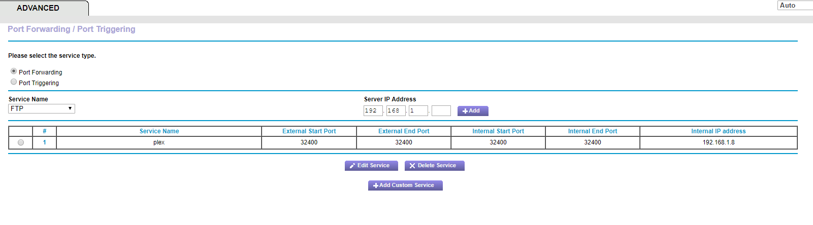

Tried doing that and i ran into the same issue.
two screen shots attached
