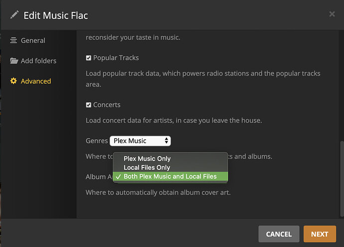

There are a couple settings for local assets in the advanced setting of the library.

@SE56 Yes, there are, and as mentioned in my first post, I enabled “Prefer local metadata” already. In fact, I used the same settings as in my other “Music” library.
Still, I believe the issue might be related with the fact that even Windows can’t see the “Album” and “Contributing Artist” content in the metadata even though I can see it through MP3Tag.
