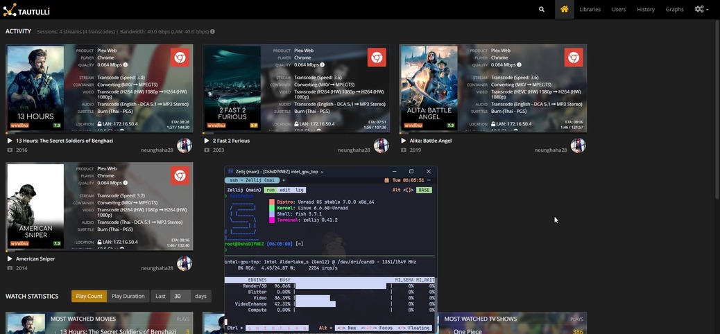

HW Transcoding fails when PGS subtitles burn in and falls back to CPU only

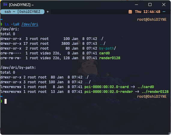

May I also see a ls -laR of /dev/dri from outside and inside the container?
ls -laR /dev/dri [host]
ls -laR /dev/dri [container]
Seeing root:video is what I’d expect.
In your container, which GID are you assigning?
Does it match the numeric GID of host-side GID for ‘video’ ?

Looking on the host side,
is UID 99 a member of the ‘video’ group (group which owns /dev/dri) ?
Unless the UID is a member of the group, it will not have permission to access the hardware.

unraid uses UID and GID it never had any issues running the container.
and pass /dev/dri to container. I also have emby server set up the same and it works HW without any issues.
If I revert back to version 1.40.5.8921 with this setting everything works fine without any issues.
I have tracked it down to the fact that the PGS stream changes size mid stream, which the HW filters are not happy about. I am investigating what I can do about it.
