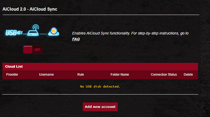

What’s this “AI Cloud” in your router settings? Sounds like something to be switched off.
not sure anything related to AI Cloud ?
