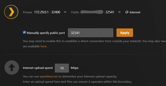

If you mean by that enabling this check box
then this is useless by itself.
It has to be used in conjunction with a “port forwarding” that you create in the settings of your router.
It is very much recommended to use a random port number on the WAN side of the router. But on the LAN side it must be 32400.
The port number on the WAN side is what you put into the field in the above screen shot.
