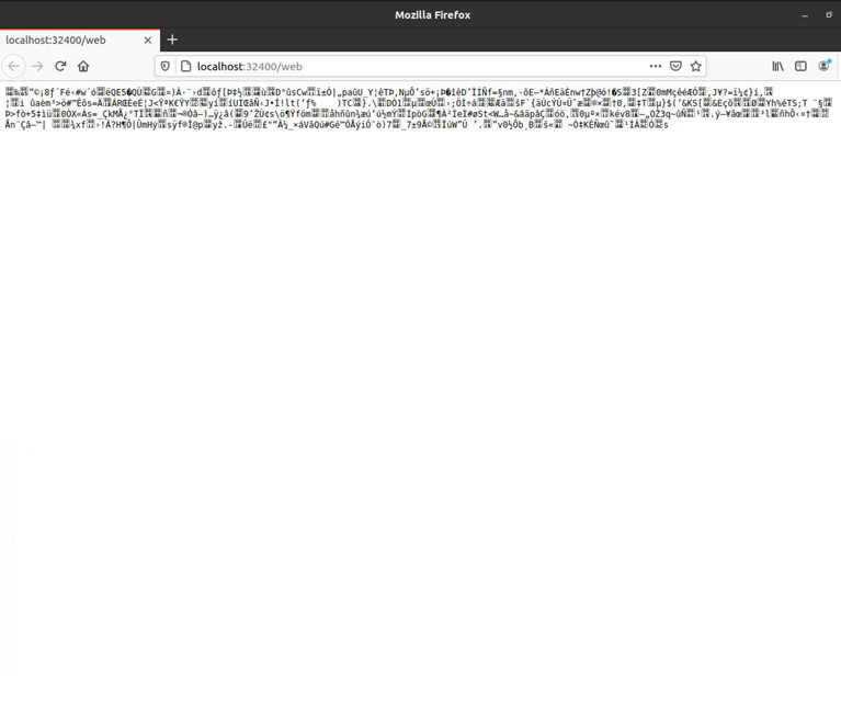

I’m getting an issue with Plex server. My plex is on the latest version and I access the server from a web player. I no even know what error is it. When I try to access the “localhost:32400/web” on the server, only shows these random characters.

turn off your javascript execution blocker.
Plex is sending you the web page. Firefox isn’t “executing” it.

That’s really odd.
If PMS isn’t running, then i’m confused how you had something respond on Plex’s port and URL.

For some weird reason, there is something already using Plex’s port.
Make sure Plex Media Server itself isn’t stuck?
ps -ef | grep -i plex
If not there, then I need ask, what are you running which interacts: Proxy? Tautulli? Something else ?
