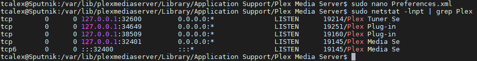

1# At the initial setup I am unable to access the plex server at 127.0.0.1:32400 (It does work with a ssh tunnel at localhost:8888).
When I check my Netstat it seems that 32400 is not binding to the usual local 127.0.0.1 and its a IPv6 instead of a IPv4 like the rest.

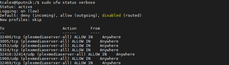

In ufw all the ports are being allowed and IPv6 is disabled at all (I tried with IPv6 on too, no difference).

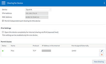

Before I thought of uploading my problem here I tested it on my own windows desktop, installed plex server, did the portforwarding (I have a upnp router but for some reason it does not pick up the 32400 TCP) and on windows it worked fine, great actually.
Retried the same on Ubuntu, portforwarded it, it stayed on available for 5 seconds, after which it defaulted back to not available.

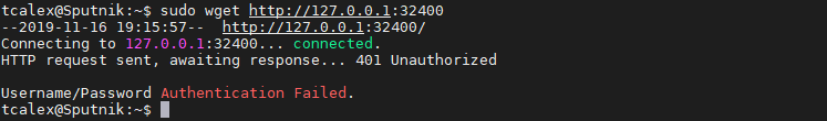

Check the curl 'http://127.0.0.1:32400' output. It should be HTTP for ‘Permission denied’ if PMS is at all running on the host correctly.
I checked 127.0.0.1:32400, connectedand Authentication failed (I assume same as Permission Denied).
Wget
cURL
That confirms the server is up.
