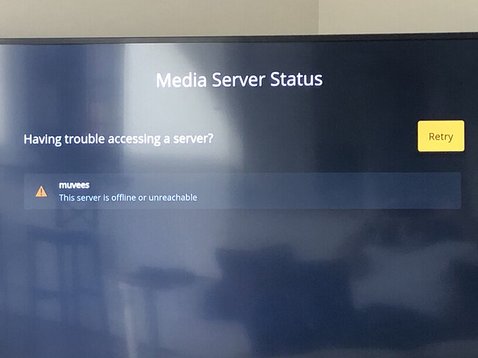

I am able to login via Safari and connect/stream on the server. My Samsung TV app doesn’t connect - “SERVER UNAVAILABLE”. I left early access and went back to previous Samsung TV app. No change

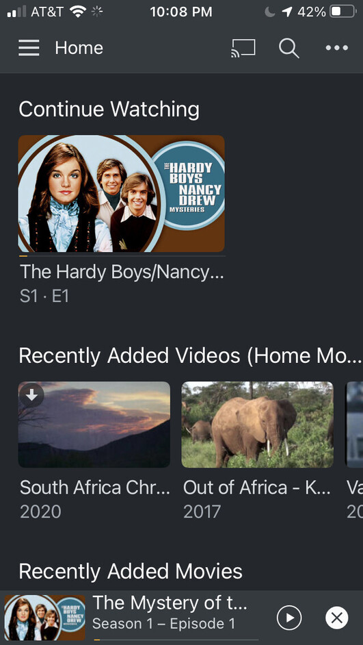

Thickening more - works from my iPhone too!
Works from Plex for Mac app as well!!
Is this just a Samsung TV app issue? I’ve changed everything I think that’s appropriate on the server and in the Samsung TV client but nothing works.
Since its working on the “web” , Plex Mac app, and iPhone apps, I think the connectivity is correct in my router.
Any help? Does anyone have a Samsung TV app running/working?
Attached is proof that the Plex Mac app and iPhone apps work.

Hi @fspatt, but it’s working because Plex server and your device are on the same local network right? I can see your iphone connected to a wifi.
What’s the Operacional System you’re running Plex server on?
Hi CostaHT - no the plex server is 6,000 miles away! The TV, iPhone, and laptop (Plex Mac app) are all on the same network.
The Plex server is running on Win10Pro.
You want to troubleshoot it right now? Let’s make it work :smiley:
sure! Love too.
@BigWheel we need your expertise. Basically, fspatt is behind a CGNAT and some of his devices are able to connect using 2Mb relay (plex pass), but his TV cannot reach the server. Anything you thing we can do ?
