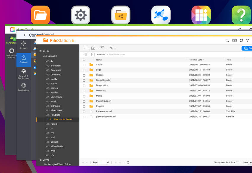

From the QNAP FileStation this is what I see, the shares I’ve created plus a few created by QNAP iteslf (Multimedia, Public, Web):
qnap

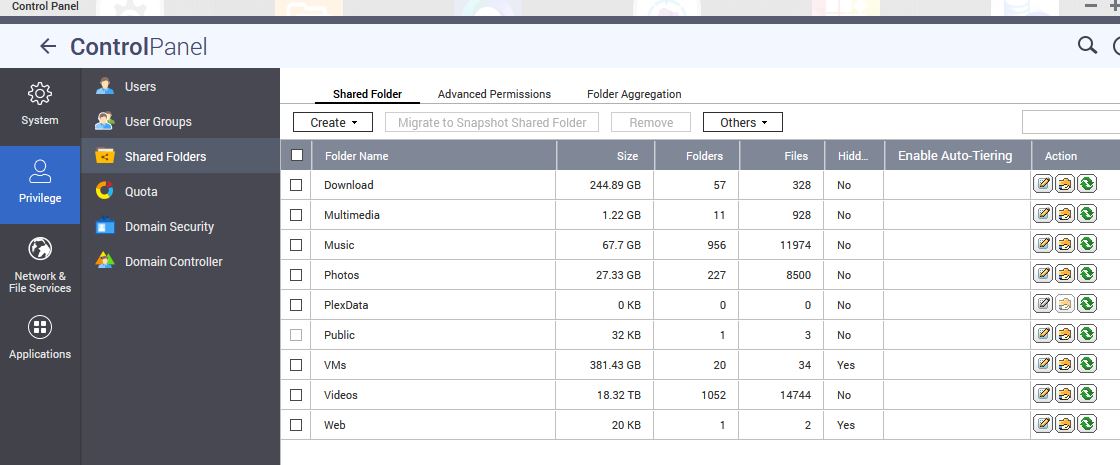

Also meant to add this earlier. From the Shared Folders section in the Control Panel. The PlexData folder is there but I cannot adjust/change permissions:

  4. Using FileStation, as admin, NOT your PC, confirm you see Plex Media Server in PLexData.
So after poking around the QNAP a bit I’ve discovered that in FileStation that if I toggle the option to Hide Volumes, the PlexData folder shows up in the folder list. However, it is not accessible and when selecting it I receive an error “The file or folder does not exist”. And as mentioned in my previous post, it does show up as a shared folder in the Control Panel, but I cannot change or adjust permissions. I tried turning on the advanced folder permissions, but that made no difference.
The Plex server created the PlexData folder a long time ago, predating my current issue. But perhaps it did something incorrectly, making it inaccessible to my admin account?
