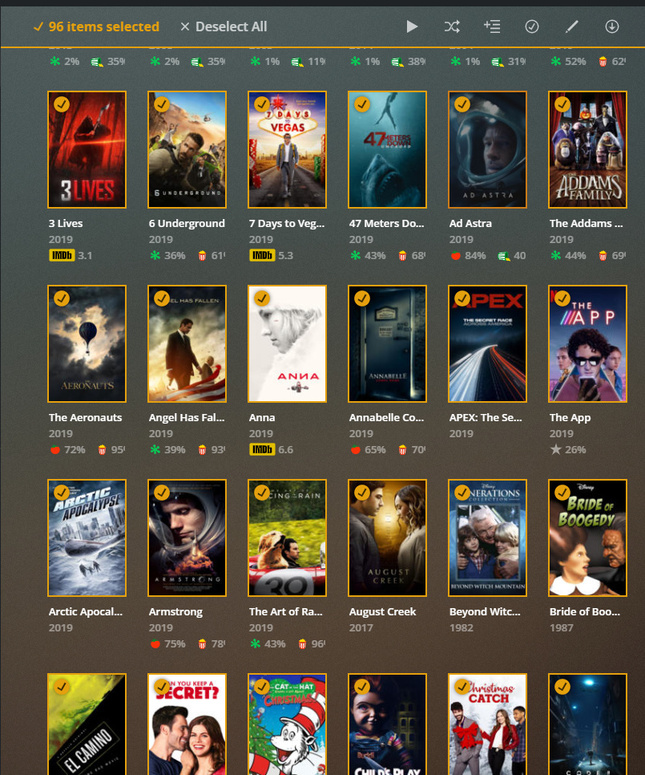

First, my library is set for rotten tomatoes, and I have been getting a lot of imdb ratings along with RT ratings.
I performed the init.py edit above, cleared caches, restarted PMS.
~96 movies where either not rated or had imdb ratings. (edit actually there are more than 96 because there are a bunch of others all scattered within the rating sort).
There doesn’t seem to be any easy way to find or filter only IMDB rated videos.
I selected them and did refresh metadata, and most of them pulled RT, but a few still pulled IMDB ratings (which should not be happening since I do not have imd ratings enabled for any libraries).
