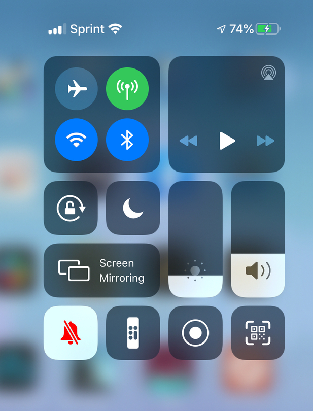

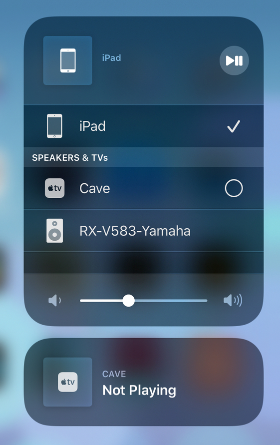

Bring up the system control panel, tap the airplay icon top right of the media controls, select airplay target, profit.

the system air play menu (the top right icon of the first picture above) should be able to do everything that prism does.
