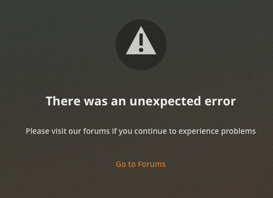

"?" in Plex Sidebar. Can't Manage Libraries. Can't Use Plex DVR. "There was an unexpected error."
Server Version#: 1.21.1.3876
Player Version#: 1.25.0.1511-47afccd4
OS: macOS Big Sur 11.1
Server logs and screenshots attached. Log was set to debug, not verbose.
Issue in both Plex for Mac and Web interface.
First noticed tonight when doing the mandatory delete + create of Plex DVR to migrate the guide. No idea if the problem was present before that.
  1. After doing the delete + create for DVR, found I couldn’t remove any of my previously scheduled recordings.
  2. Clicking on any existing recording would give a “There was an unexpected error” error message.
  3. Was able to delete all preexisting scheduled recordings via mobile app.
  4. Also couldn’t add recordings in web / Mac app without the same error.
  5. Was able to create new scheduled recordings via mobile app.
With old entries deleted and 2 new show recordings created, started clicking around to determine root of problem.
  1. Noticed a sidebar entry that looked like a library entry with a “?” icon and no label. No idea what it is.
  2. Went to Settings > Manage > Libraries, and got the same “There was an unexpected error” error message as before. Unfortunately, you can’t actually do that kind of management via the mobile apps (which frankly is annoying), so I can’t use the same workaround there.
  3. I can pin and unpin the blank “?” source freely.
Clearly there’s something wonky with my server’s sources/libraries, but I don’t know when/why it started and can’t seem to use normal means to edit.
