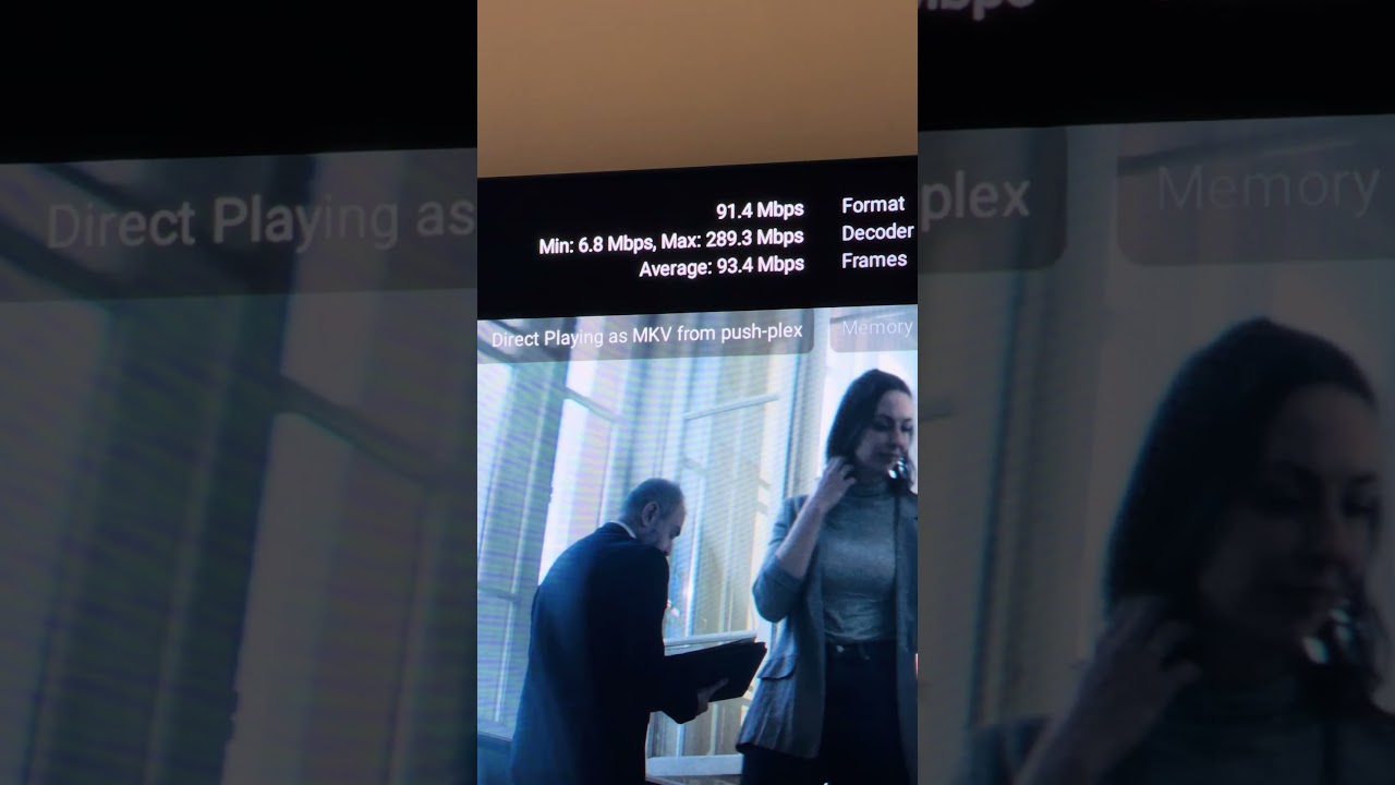

Updating that the nvidia shield version is 10.30.8.4222 (58d01a81). You can see instead of a sufficient buffer with a pause between download bursts it’s constantly downloading tiny chunks of the movie but that artificially drops both the average and peak download speeds since it never really settles in. It seems to me like a dynamic buffer length is required based on the bitrate. Or at least let us pick the buffer size.

it’s constantly downloading tiny chunks of data
You can say whatever you like but these aren’t tiny chunks.
Tiny chunks from a timescale not from a data amount standpoint. I wrote that wrong/should have been clearer.

I mean, define tiny chunks? At a packet level, they are tiny. From what it looks like is that plex is requesting 2-4 second chunks of video at a time to keep its seemingly smaller buffer full (which I would consider tiny, again).
From my poking around, it seems to be a problem with how plex streams the content (HLS). It requests content in 2-4 second chunks (small), which on high bitrate content can be like 40+ megabytes, only then will it request the next chunk. Add some latency, some normal TCP backoff, and sprinkle in a little packet loss and it’s a recipe for disaster. Contrast that with infuse which is greedy and just says “fill my buffer” it’s much more efficient.
