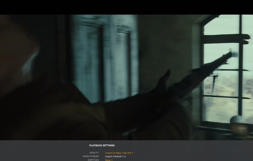

Intel Quick Sync transcode quality issues on Intel 12th/13th gen CPUs
1917 - 1:05:00 > 1:07:00 for the sample - x265 / HEVC transcoding with an 8~ mbps average file. Grab someone from the team with a Samsung TV and have them test with subtitles enabled and observe the quality.
Since we’ve already confirmed this issue does not occur on older gen hardware with QSV, or at all with NVENC, I can’t imagine this being related to bad input data as we already have a confirmed working state.

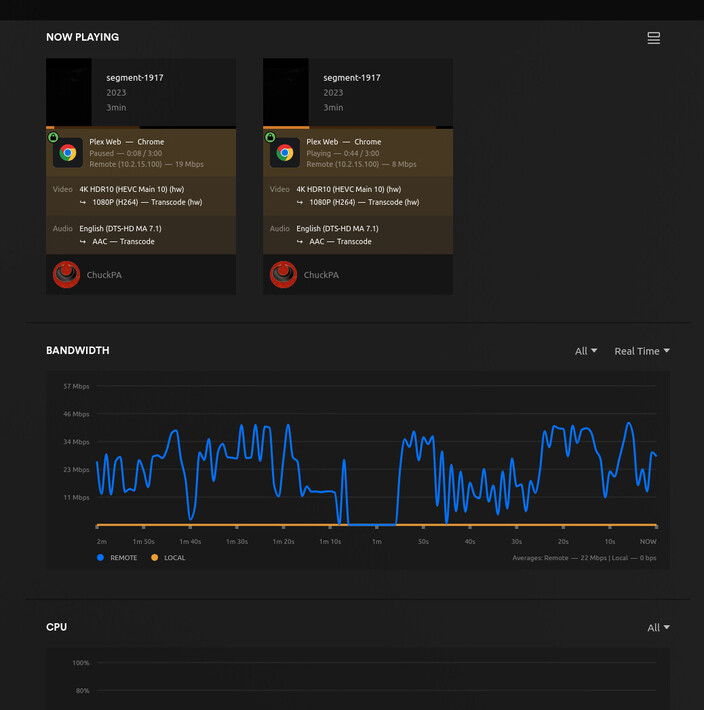

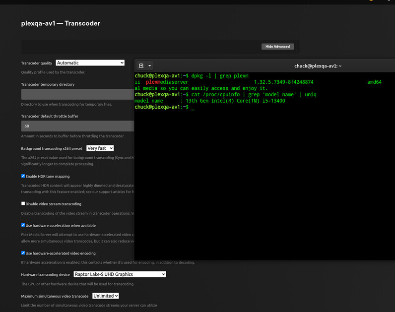

I just finished transferring this to our AV1 machine and playing with QSV
at 8 Mbps on both Plex/web, Nvidia Shield, and LG TV. NO artifacts or aberrations of any kind
https://drive.google.com/file/d/1DE9sDpkEacqcRaa7OGe748l8RWtnbp95/view?usp=sharing

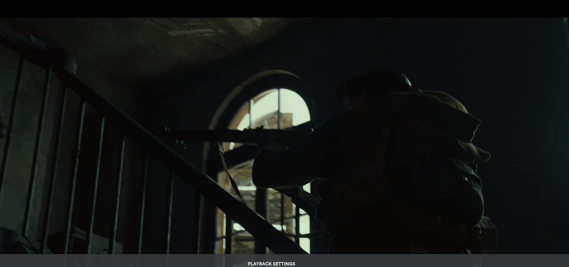

@ChuckPa Thank you for grabbing the sample on your side and testing. What is the result of playing the sample I provided on Nvidia Shield and LG TV?

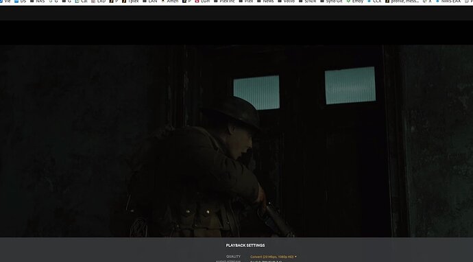

I feel it’s necessary to reiterate this… Regardless of the “input quality” of these video files, the fact that they transcode without quality issues on the previous generation CPUs with UHD 630 or equivalent indicates there is a problem of some kind, either with the driver or transcoding libraries. If I take Rozzly’s sample file and put it on my i5-10400 machine with a UHD 630, the file transcodes fine. Same with my own files that I have trouble with.
I understand this seems to be a edge case… Maybe people are not noticing or don’t care enough, don’t use transcoding because their hardware supports directplay/stream… Maybe there aren’t enough people on this newer generation hardware, or they just don’t bother to speak up. But to chalk this up to “your video quality is bad” is just dismissive when we can clearly see the quality is fine on previous generation hardware.

@ChuckPa , any update? I’d like to know what the result is of playing the sample I provided on your Nvidia Shield and LG TV.
Hey,
Sorry not to post back sooner; been busy
I tested in the LG app, Nvidia Shield, and Web
  1. The LG app would not start for me. It goes to sign in and then hangs forever.
  2. The Shield plays flawlessly
  3. web plays flawlessly
I think the LG app went toes up on me. It worked last week but now does not get to the main menu (even after reinstall). It’s useless the instant I sign in.

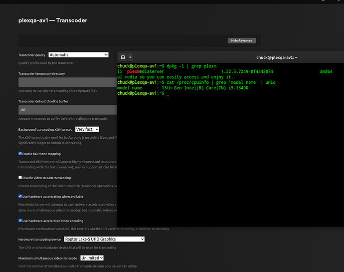

Installed PMS:
ii plexmediaserver 1.32.5.7210-77f7f99fa
I play it on UHD 630 – :white_check_mark:
I play it on Radeon RX Vega M – :white_check_mark:
so what happened?
I haven’t a damn clue.
Right, UHD 630 is older gen hardware that does not experience these issues, so these results are to be expected. This needs to be tested on 13th gen hardware with the UHD 770 through QSV.
You should be able to reproduce the results with the sample provided in the web player, but not through other players, such as your nvidia shield or LG TV. This is what I am trying to confirm.
I don’t know what i might have been drinking but I still can’t reproduce it on our RaptorLake on Web or Nvidia. As for the LG, it’s a lost cause at this point to me. I can’t reliably test with it until I know what happened. (Monday)
This is playing at 20 Mbps.
Taking it way down, still no failure
Is this with the sample file I provided?
This is my 4 minute clip (linked above).
I took your time stamp and then extended the duration to 4 minutes

Major thing to note here Chuck, your raptorlake is running a UHD730, not the UHD770 that rozzly and I have issues with.
The 770 has 2 “Multi-Format Codec Engines” while the 730 only has 1. Not sure if that is part of the issue or not.
Also odd note here, but my UHD770 on an i5-13500 shows as “AlderLake-S GT1”.

I re-ran Rozzly’s sample on our AV1 machine. Again – No issues.
I understand your assertion it’s a UHD770 problem, I also see the possibility of going the other way; A source media problem.
