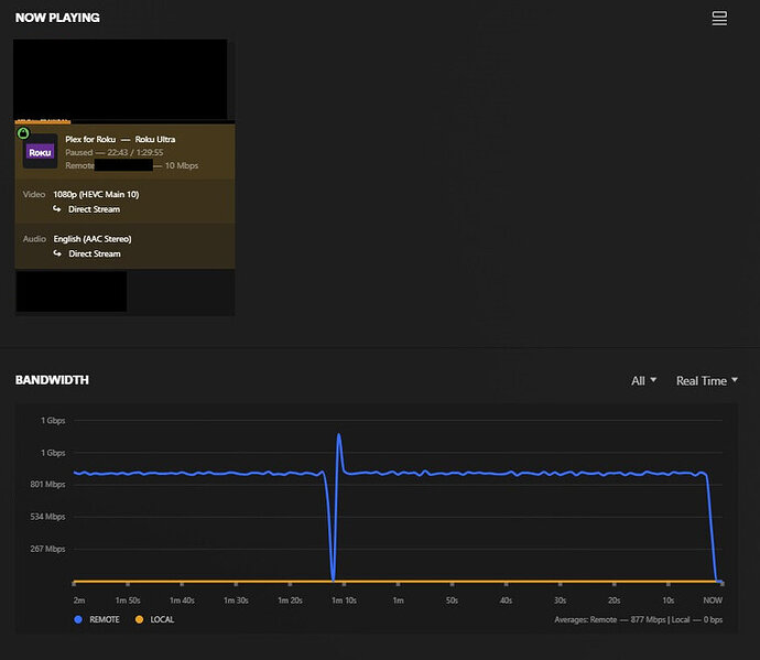

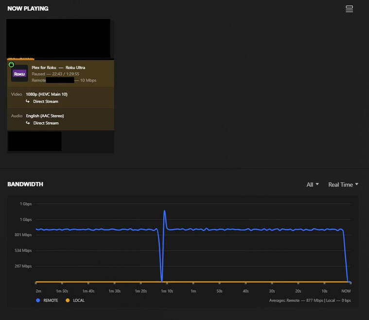

I am running the latest server version: 1.32.7.7571 and I ran into an issue where a single remote stream was saturating my upload bandwidth in 5 minute segments once every 15-20 minutes or so. I have gigabit upload and the media file averages 6,250 mbps bitrate, so this still doesn’t make much sense.
Nonetheless, under the Remote Access settings, I decided to set my internet upload speed to 600 Mbps and Limited remote stream bitrate to 15 Mbps (1080p) - Both were formerly set to unlimited / original respectively.
For testing purposes, under network in settings, I removed the two entries added to the LAN Networks section (192.168.0.0/16, 10.0.0.0/8) so that my local streams would fall under the remote restrictions.
After limiting the playback to 15 Mbps, the artifacts appear much-much less. In a 5 minute segment where an unlimited playback piece would get 8-10 artifacts, limiting the bitrate only produces artifacting maybe 1-2 times.
Once adding my local network subnets back to the Lan Networks in the settings, I can confirm the artifacts get much worse during unrestricted playback.
Edit I just tested on my secondary NUC running server version 1.32.5.7349 , used the sample file provided previously, limited remote playback to 15 Mbps, and removed local subnet entries. I did not have a single artifact / stutter during the entire clip.
