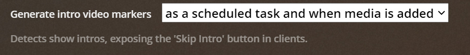

For some reason intros are not being detected for any of my TV shows, thus not allowing me to skip intros. I tried to force it on “The Office” but from what I can tell, it doesn’t even attempt to detect them. I also made sure it’s turned on as a scheduled task & when media is added.
