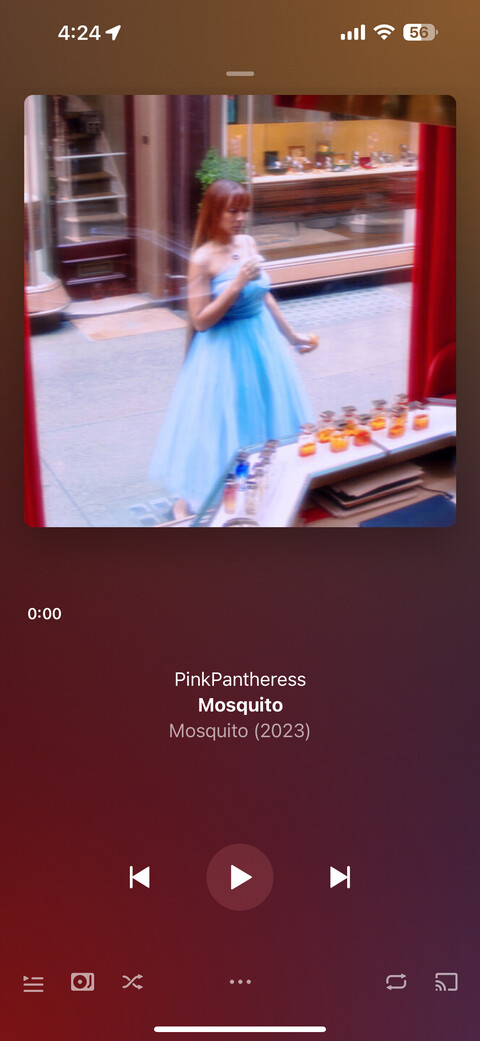

I have been having this issue for a few days on my iPhone running 16.6.1.
I open the app and am able to search my library without issue. I can load artists and albums without issue. When I play a song I am stuck in an infinite loop of loading the song.
I am able to load the music fine with the regular Plex mobile app and other devices are not having this issue either.

I’m having the same issue, logs attached.
I can force close the app, restart my phone, etc. Whenever I open Plexamp it’s stuck in this state, trying to play this one song I last played. I can’t even hold the play button to clear the queue. If I try to start playing anything else it loads forever.

Swipe down or hold down the play button to clear things out.
The app is so stuck I cannot even do that. Holding down the play button makes the normal haptic feedback, but then nothing happens.
hmmm… can you swipe down, try to play something else, and then post logs?
