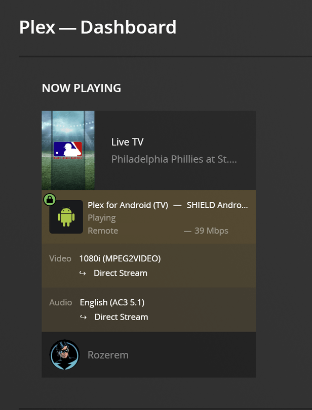

Here is the dashboard when streaming live tv:

The same stream shows:
I did notice that the video does lag a bit sometimes but right now for this live sports…it is running pretty smoothly which is a relief. Just odd that this audio setting seems to resolve the issue.
