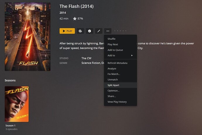

It is possible to split a tv show. The option is only available at the show level.
Was just typing basically the same as above
But when I try to split a show that is in 2 resolutions it just spits out an error.

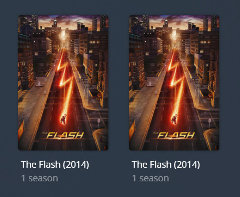

and this is what I get when attempting a split:

Ok, So I renamed the folder of the 4K version to The Morning Show 4K Scanned the Library and refreshed the metadata for the show.
I then tried a split. It still spat out the same error as posted above, but it has actually split them.
So it appears to be an issue if you have the same show in 2 different folders but the Show Folder has the same name in both Folders.
