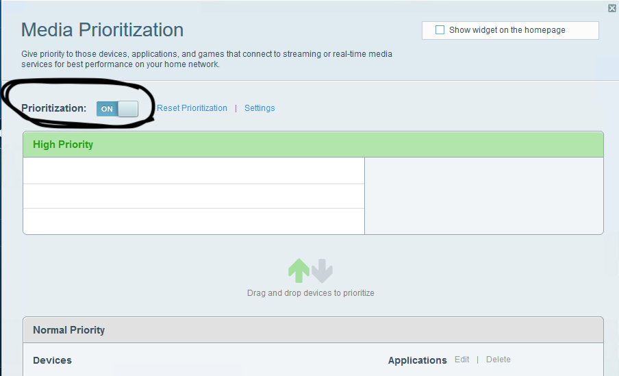

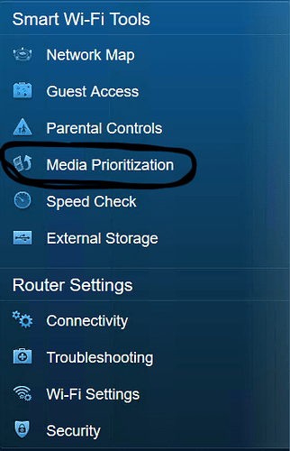

Hello, OttoKerner! Not gonna believe this. It’s not Windows 10 Firewall. I have Linksys EA8500 Smart WiFi MU-MIMO Router. APPARENTLY, there’s a feature in there called “Media Prioritization”. With all honesty, this has never been an issue in the past until now. All I did was toggle it on, and everything was working. I did not set anything in order, just turned it on. My opinion, it seems to be a glitch in Linksys firmware. Either that or that feature is conflicting with the Windows Firewall. So, the issue is resolved and hopefully it’ll help anyone else out there. BUT, I would love to know why it’s occurring.
Lol July 2019 right now and your Linksys post helped me as well. I absolutely cannot believe thats what my problem was. 2 different Plex servers internally both not working. I’ve been messing with countless OS installs, ports, and firewalls for 5 days straight. All kind of Plex and Plex account troubleshooting. Unbelievable. Switched the Prioritization on and bam its working. Much thanks man!!
