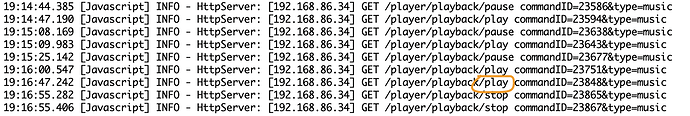

my logs posted above should include the time when I was observing this (the Pi playback stops responding to play/pause, or doesn’t respond consistently) … I think it was Aug2 around 8pm timestamp while I was jumping around tracks and making a playlist
have seen it multiple times since then, sometimes during playlist, sometimes during continuous album, once it starts happening it seems to continue until I restart plexamp on the pi
If I look for HttpServer: logs I see a fair number of them in the 8 PM timeframe. I might need some more details around what you’re seeing it ignore, now that you know what to look for.

** failed to pause at ~ 7:16pm **

Interesting…it does appear that at 19:16:47 it received a play instead of a pause. I assume that at the time the player UI showed a pause icon? If anything, it appears the flaw would be on the controller side.
