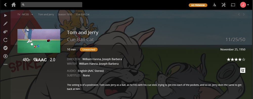

and having just placed a test file (named as shown) into the directory structure above I can report an instant, first time, fully populated match with TVDB and Plex.
TV Show Name - SXXXXEXX - Optional Information (YEAR).XXX
Ever the investigator and always curious how it is possible for folks to screw up a perfectly good file name I Plex Danced the series I just placed after ‘screwing’ up the name just as @juherr has and found that Plex and TVDB have no problem with it and I got the same satisfying instant fully populated match I got before.
