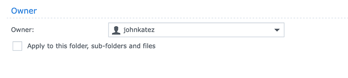

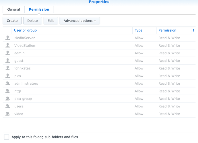

My Shared Folder is called “torrents”, dumb name, I know- but you’ll see Plex has R/W access. Inside that is a “TV Shows” and “Movies” folder, Plex has R/W access to those, I even made Plex the owner of Movies to try and help? Inside that folder is a movie folder “The Perfect Weapon (2020)”, which Plex has R/W access to but the owner is a different user (johnkatez), AND the movie file inside is owned by this user (johnkatez) and Plex does not have R/W access. See screenshots.
It’s almost like the “Apply to sub folders and files” is getting reset for new files?
Permissions for Shared Folder:
Permissions for Movies folder inside shared folder:
Permissions for The Perfect Weapon (2020) inside Movies folder:
Permissions for the file itself:

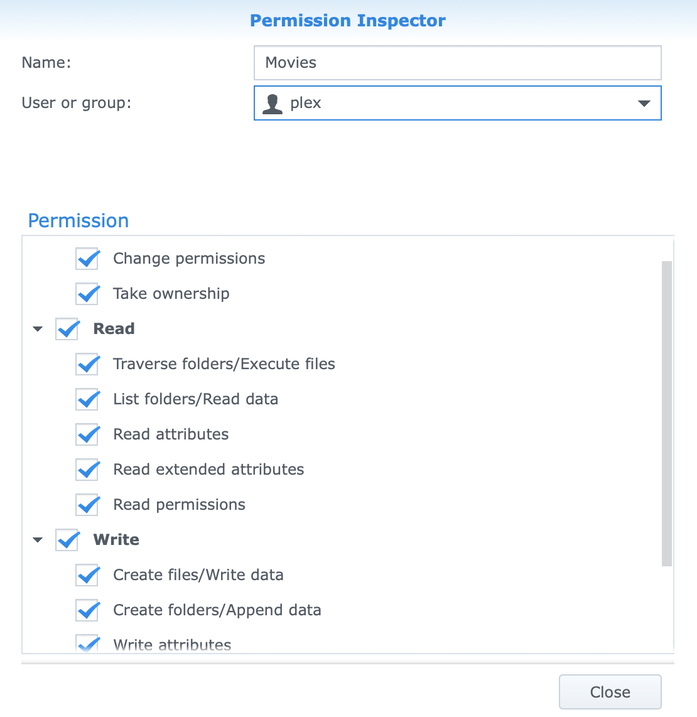

Also, when I look at permissions inspector for the Movies folder, Plex is good to go:
But the The Perfect Weapon (2020) folder INSIDE the Movies folder does not inherit those settings… even though I keep checking the Apply to sub folders check box.
If I check the Apply to sub folders, the issue is temporarily fixed and Plex will find and add the file UNTIL I add a new movie and I have to repeat the process.

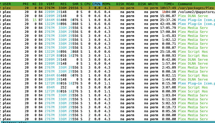

IDK if this has anything to do with anything but Reddit told me to check the privileges via htop on Terminal and it looks like the user doesn’t have R/W access even though it does on Synology.
you are running htop on the synology?
It’s not related to this problem. HTOP is about processes not permissions
