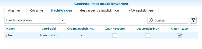

That’s strange, because user Plex does have read access to that folder.
See the screenshot (in Dutch, with “alleen-lezen” meaning “read-only”)

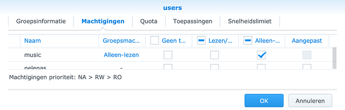

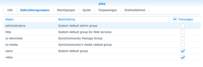

Maybe this is the problem? Plex user is only member of the “users” group (and “video”, for the transcoding features)
but that users group has read access to the music folder.
