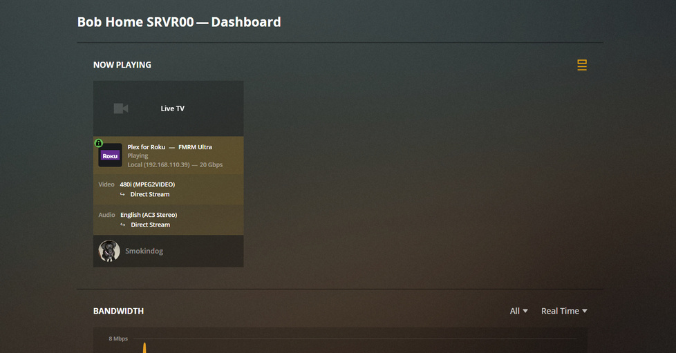

Well I’ve got direct play enabled and I’ve tried with and without the enhanced player but the dashboard shows nothing when I switch to my ATV. On the ROKU a device shows up and definitely is NOT transcoding. OTA - LaffTV - “According to Jim”

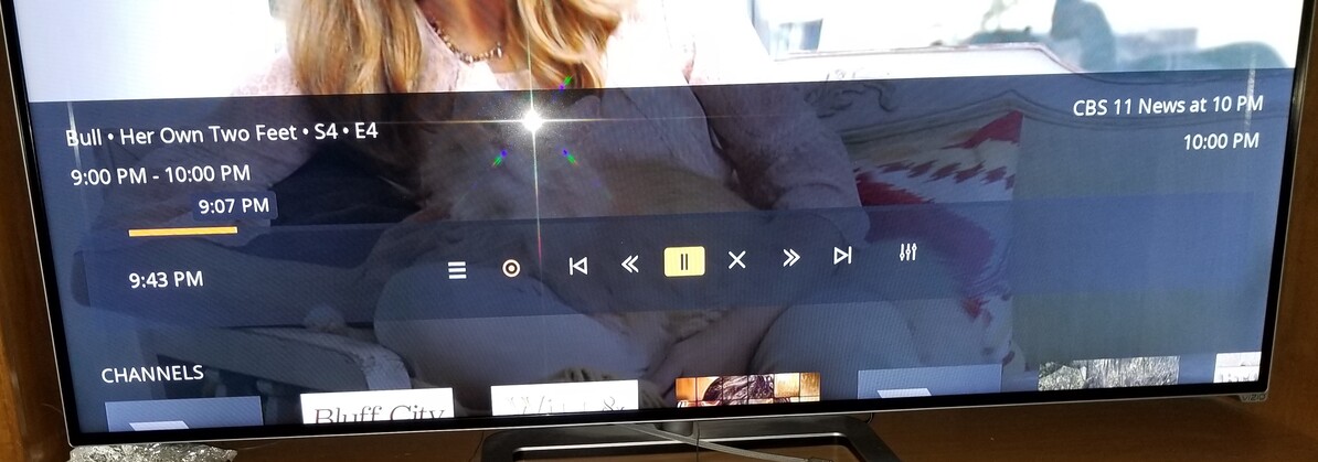

Here’s what it looks like on an ULTRA perhaps 99% of the time. Notice the actual time (9:43) versus the progress timeline (9:07, the time I joined the showed being recorded which BTW NEVER changes). NO option to view from beginning was given and NO attempt at time shifting has been made because I know it will fail. The show is BULL on CBS so you can validate that it’s a new episode (no start from beginning option).
