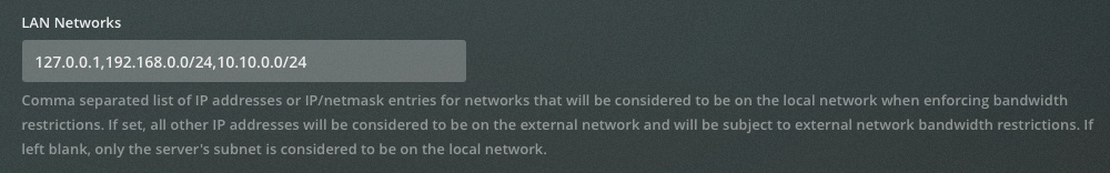

Plex may be applying remote bandwidth restrictions to the playback due to the VPN network being seen as remote. You can ensure this doesn’t happen by adding your VPN network to the list of networks to be treated as local under Settings -> Network:
In my case, my VPN network is 10.10.0.0. So, when I’m connected remotely through my VPN, my phone has a 10.10.0.x address, and PMS will now treat it as a local connection (my LAN is 192.168.0.0).
Thanks mate, that seems to have fixed it.

Plex uses network location information to determine the bandwidth available for streaming media. On local networks, it imposes no restrictions generally (by default) and the full speed of your link is available. Anything remote has restrictions applied as configured on both the client and the server’s remote access settings. If PMS determines that insufficient bandwidth is available to stream at original quality, the media will be transcoded to a lower bitrate to accommodate what is available. There’s some additional information available here:
